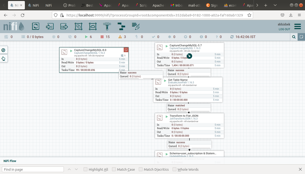

I want to connect connect two different MySQL database services(mysql 5.7 and Mysql 8.0 ). I am using two  two CaptureChangeMySQL Processors for this.
Mysql 5.7 is install in my local machine and CaptureChangeMySQL Processors connecting successfully.

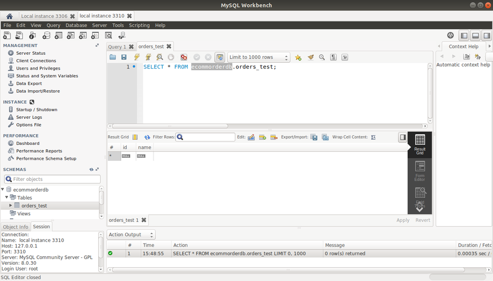

 Mysql 8.0 is install on docker container and on host machine port 3310 like (sudo docker run --name mysql-8.0-container -p 127.0.0.1:3310:3306 -e MYSQL_ROOT_PASSWORD=password -d mysql:8.0).
CaptureChangeMySQL connecting with mysql 8.0 is giving  error.
Can any suggest why i am getting this error and how to resolve it.
Note: I am able to connect mysql 8.0 using mysql workbench.CaptureChangeMySql-8.0-configuration.pngTwo_MySql_Server_Connection_NiFi_Diagram.pngScreenshot from 2022-08-03 16-44-47.png
