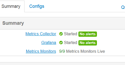

we perform service check to Ambari Metrics
and we get the following errors - "All metrics collectors are unavailable"
what we can do regarding that , in order to solve the problem?

Few checks will be good to perform:
1. To verify is ambari is showing false Running AMS services? Please check the AMS collector hosts if the AMS collector is actually running and listening to the correct address/port:
# netstat -tnlpa | grep 6188
# hostname -f
2. Please verify if the AMS process PID are matching with the PIDs that are listed int he following files. Some times not matching PIDs causes false info in the UI
$  ps -ef | grep ^ams | grep ApplicationHistoryServer
$  cat /var/run/ambari-metrics-collector/ambari-metrics-collector.pid
$  ps -ef | grep ^ams | grep HMaster
$ cat /var/run/ambari-metrics-collector/hbase-ams-master.pid
3. Can you try restarting the AMS collector Service once to see if you notice any error int he AMS collector logs?

@Jay after we set the corect date on all machines , now ambari metrics service check is ok , do you think this is logical ?
Michael-Bronson
Master Mentor
@Michael Bronson
Yes, the AMS basically posts a dummy metrics to the collector with start & End time as mentioned int eh script (which is a relative time) so time difference can be a valid reason for failing service checks.
