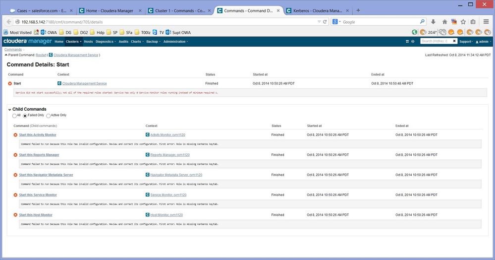

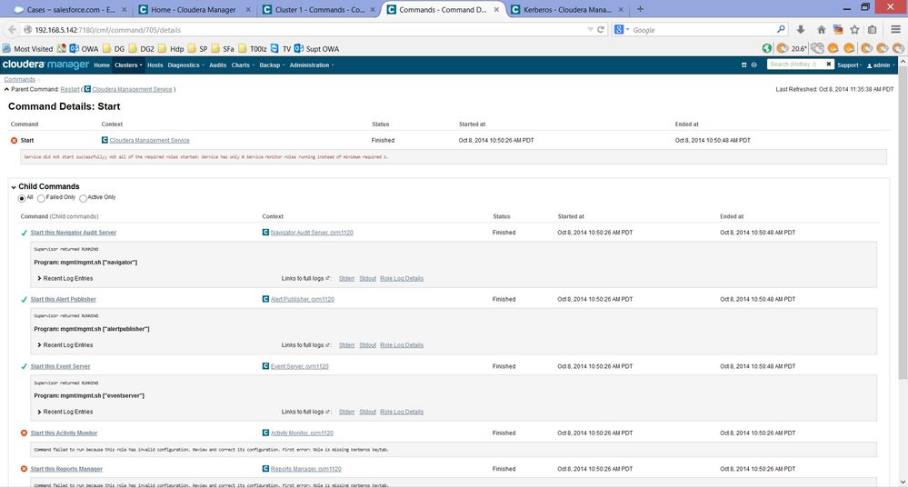

Now for my next adventure; I've created all the necessary Kerberos pricipals, keytab/krb5.conf files and scp'd them over to the nodes on the cluster... and then started the Kerberos set-up using Cloudera Manager. Everything seemed to go very well... until after all configuration changes were made and the cluster was restated. That's when disaster struck. :-0
it seemed to choke on the restart of Cloudera Management Services starting with Activity manager onwards as seen below.
So to provide more, here's a screenshot of the failed commands;
So now what I have is a cluster that will not start and there doesn't appear to be a clear way of rolling back the kerberos set up.

Okay,
I'm today's cheap entertainment... problem solved! 😄
Someone disabled the krb5kdc service on our KDC server (AAARRRGGGHHH) 😮
so a simple service krb5kdc start there allowed the rest of the Kerberos set up to complete and we're back up using Kerberos.
