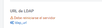

the next image shows the restart notification to apply changes, but it has already been applied several times.

Hi guys , problem reporting
In Cloudera Manager , Now Ldap is funtional but the message " Restart service " persist .
Regards!
Created ‎08-16-2022 06:34 AM
- Mark as New
- Bookmark
- Subscribe
- Mute
- Subscribe to RSS Feed
- Permalink
Hi @noekmc , Are you referring to the below "Restart service" highlighted option that you see under ldap_url? If yes, it is expected and you can refer my earlier comment.
