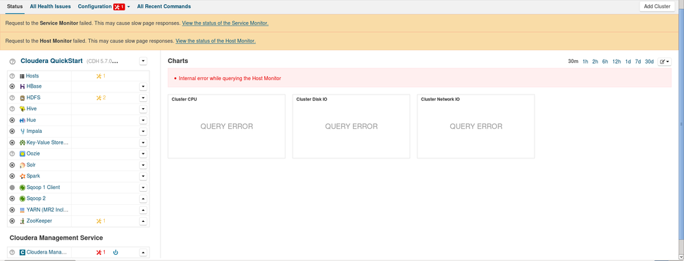

Recently, I've installed the cloudera-quickstart-vm-5.7.0-0-virtualbox. I need to do a project using PIG and Hive.
I find errors from the beginning... For example:
- I need to restart the Hue Service in Cloudera Manager every time that I begin a session in VM;
- My PIG Script (which is very simple) don't exceeds the 0% of progress

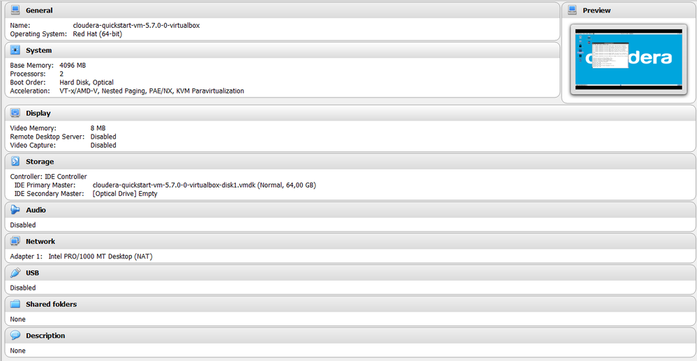

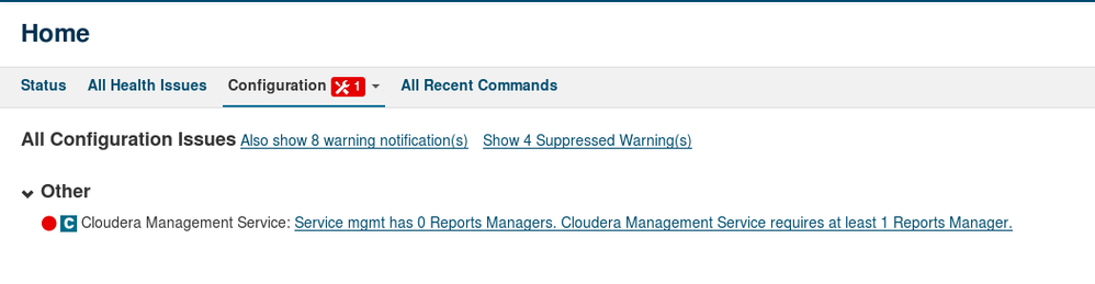

I put the erros that I see in Cloudera Manager and my VirtualBox settings. I don't know if the bad performance in PIG is related to this.
Someone who had this problem? Its urgent! Many thanks!!!

The first thing to look at is the amount of RAM allocated to the VM. If you are using Cloudera Manager you need a minimum of 8gb of RAM. Depending on what you are doing with the VM you may need to go above the minimum.
