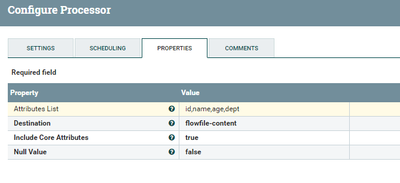

Now you need to prepare a json message use AttribiutestoJSON processor
Change the property
attributes list as
id,name,age,dept
This processor now prepares new json message with all the attributes you listed in the processor.
{ "id": 1, "name": "HCC", "age": 20,"dept": "community"}
Use the json result from Attributestojson processor to store into mongoDB.
AttributesToJSON Configs:-
