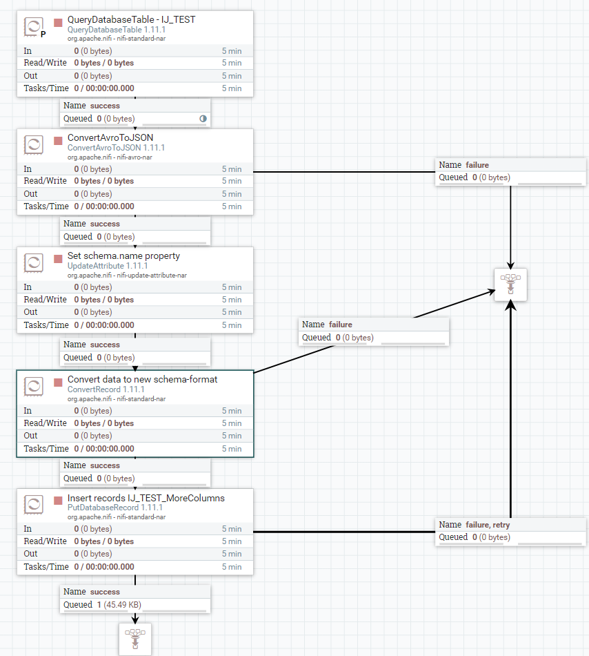

@ang_coder   Tried it myself and have to correct my idea a little bit. Have a look at my example.

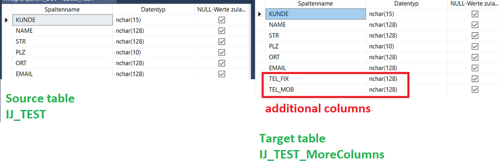

Here are my tables. The target table has two columns more than the source.Tables

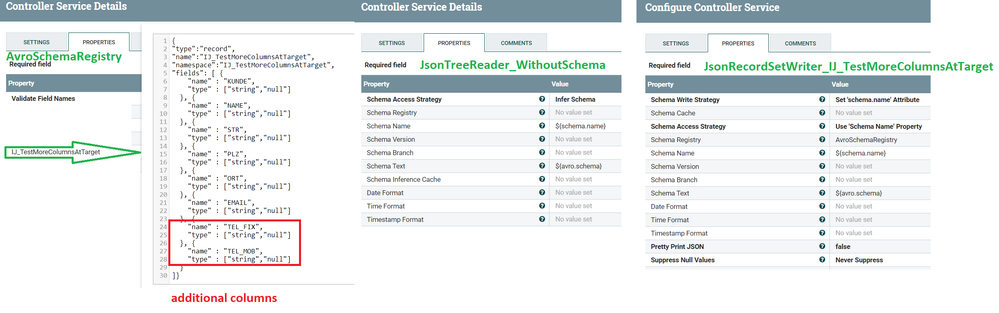

I defined following ControllerServices:ControllerServices
And created this flow:Flow

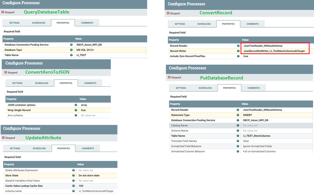

Here the information of the single processors:Processor information
In my example it works.
Sure there will be a more elegant solution but I don't know how.

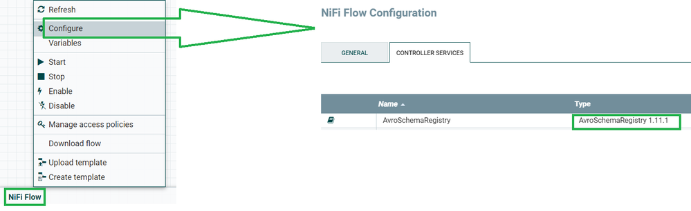

The AvroSchemaRegistry is to set in the ControllerServices.
If it should be available in your whole NiFi just go to the canvas and click anywhere right -> choose "Configure". It is the same place where you define your database connections.
Configure -> ControllerServices

The ConvertRecord in my example uses an JSON-reader and JSON-writer where the writer points to the AvroSchemaRegistry with the schema.name set in UpdateAttribute. Therefore the JsonRecordSetWriter_IJ_TestMoreColumnsAtTarget (just to take a short name) has the specification "Schema Access Strategy" with option "Use Schema.Name Property". Have a look at the configuration details in my post before.

But if you use PutDatabaseRecord instead of PutSQL you have to specify a RecordReader. This will be configured as ControllerService and you can add a schema in AvroSchemaRegistry (also in ControllerServices). In this schema provide the full table definition with default values.
f.e. {
"name" : "zeichen",
"type" : ["string","null"]
I suppose that all columns which are not included by your flowfile should be taken from the schema considering the default values.
