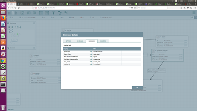

Hi,
I have my JSON file like mentioned below:
The flow for conversion for json to csv :
1. Get the file
2. Split json
3. Evaluate json path
4. Replace text
I want to see values in csv format of memberid and loanamnt and 'm getting blank for the two columns like "".""
Can someone help me in this?? Attached are the Screenshots of the processor properties.

Created on 03-13-2018 11:54 AM - edited 08-18-2019 02:33 AM
I have tried with your input Json data and processor configs,all your configs looks good. i'm able to get the flowfile with "1","1000" from replacetext processor.
Can you make sure the feeding connections to the processors are correct based on the below screenshot.
If the issue still exists then share your flow screenshot or xml so that we can help you ASAP.
Created on 03-13-2018 12:10 PM - edited 08-18-2019 02:33 AM
Add your reply is not working so have to post it as answer
@Shu Please find below the screenshot. I can see there is something different in the things highlighted in you image and mine. Can you suggest the changes i need to make?
Created on 03-13-2018 12:57 PM - edited 08-18-2019 02:33 AM
The issue is with Failure,Original,Unmathed relationship as we need to auto terminate them or connect them to put email processor to get notification if something gone wrong.
Steps to Autoterminate relationships:-
Splitjson:-
then connect only split relationship to EvaluateJson Path processor.
EvaluateJson Path:-
1.Delete all existing relationships that are feeding to ReplaceText processor
2.Right Click on EvalJsonPath Processor
3.Goto Setting Tab
4.Click on check boxes before Failure and Unmatched relationships
5.Connect only the matched relationship to Replacetext processor
ReplaceText Processor:-
1.Delete all existing relationships that are going out from Replacetext processor
If the Answer helped to resolve your issue, Click on Accept button below to accept the answer, That would be great help to Community users to find solution quickly for these kind of issues.
