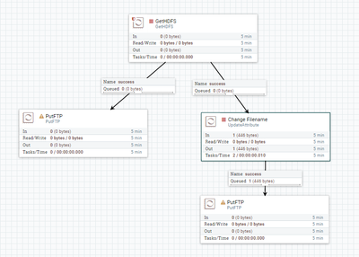

@Foivos A,
Generate flowfile processor won't accept any incoming connections,
Use one GetHDFS processor and connect same success relation to Two-PutFTP processor and keep the same file name.
The next success relation give to UpdateAttribute in that add another property to change file name of the flowfile.
First PutFTP is storing the HDFS files, storing as is into your remote location
Second PutFTP parsing the HDFS files and changing the name and storing to your remote location.

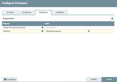

UpdateAttribute:-
Add new property to update attribute as below
${filename}.parsed
This update attribute changes the filename to samefilename(as we are having before) with .parsed as the extension to the filename by using this method you can easily find which file has been parsed and which is not parsed.
UpdataAttribute Configs:-

Flow:-
Hope this will helps ...!!!

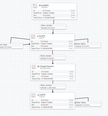

New_Flow:-
in this screenshot i have used GetHDFS processor but you can replace this with
ListHDFS--> FetchHDFS  -->  PutFTP(files without parsing)-->  UpdateAttribute(files that got parsed) -->  PutFtp
  1. You have got all the listed files in the HDFS directory then use PutFTP processor and keep the Success relation of first PutFTP processor to next UpdateAttribute processor
  2. Here we i have given failure and rejected to loop it back to the same PutFTP processor, so the files that got stored into remote location only we are processing from First PutFTP processor.
  3. All the files that got rejected or failed to store into remote location are routing back to retry one more time with the same processor.
Only the files that got successfully stored into remote location will be routed to Update Attribute processor, you can parse and change the names of the files before storing to RemoteLocation(in second PutFTP) processor.
In this method we only process the files that got successfully stored into Remote Location by using First PutFTP processor(as we are using only success from FirstPutFTP to updateattribute).For all the other relations like rejected or failed you can auto terminate or you can retry them to store.

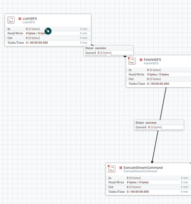

So i replaced it with ExecuteStreamCommand processor that accepts incoming connections:
The configuration of the processor:
The correct command that works from the command line and the ExecuteProcess processor would be:
ncftpput -f /path/to/login.txt /path/to/ftp/remote /path/to/localdir/filename
But unfortunately the flow does not work and i get no error messages whatsoever to debug and find out what is possibly going wrong.
I ve also tried to set IgnoreSTDIN: true and specify the local path to the filenames i want to transfer explicitly, but this does not work either.
What i would want to do is list the HDFS contents, fetch the filenames and pass these filenames as arguments to the ExecuteStreamCommand processor as the last argument. In FetchHDFS processor there is the ${path}/${filename} HDFS filename attribute, and in the ExecuteStreamCommand processor ive set ${filename} as the last argument, but apparently the files are not stored somewhere locally in the Nifi server and they are lost somewhere in the way of the flow after the FetchHDFS processor. My question is how would you approach this issue? Any other ideas on how we could achieve the same result?

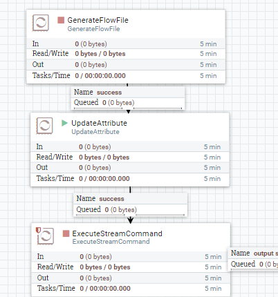

Hi @Foivos A,
i tried a simple flow passing attributes to Execute stream command, sample shell script to list files in directory
bash# cat hadoop.sh
for filename in `hadoop fs -ls ${1}${2} | awk '{print $NF}' | grep .txt$ #| tr '\n' ' '`
do echo $filename; done
Run script:-
bash#./hadoop.sh /user/yashu/ folder2
/user/yashu/folder2/part1.txt
/user/yashu/folder2/part1_sed.txt
This script takes 2 arguments and passes those to ${1},${2} above and listed out files in folder2 directory.

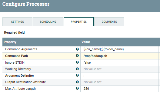

When we are running this script in NiFi ExecuteStreamCommand processor configure that processor as

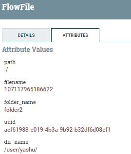

In my flow every flowfile having dir_name,folder_name as attributes as values like
dir_name having value as
/user/yashu/
folder_name having value as
folder2
Attributes for ff:-
processor configs:-

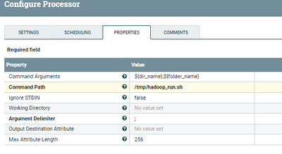

Make sure your NiFi run script is calling the original shell script(hadoop.sh) with 2 arguments as i mentioned below.
bash# cat hadoop_run.sh
/tmp/hadoop.sh $1$2
in my case i'm calling hadoop_run.sh from nifi which calls hadoop.sh script with two arguments as i mentioned above.
Then only the ExecuteStreamCommand processor takes 2 arguments as you have mentioned in Command Arguments property in our case ${dir_name};${folder_name} and passes those arguments to script.
How NiFi Executes Script:-
When NiFi executes hadoop_run.sh script it calls hadoop.sh script which accepts 2 arguments as we are passing those arguments from NiFi ${dir_name}will be considered as $1;${folder_name} considered as $2 and lists all the files
