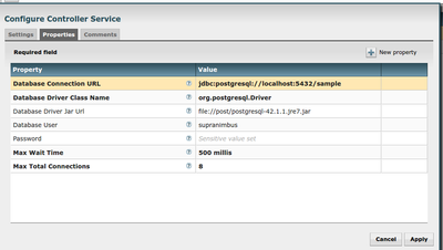

I try to access a postgresql through Nifi for that first I try to get json from RestApi through GetHTTP processor, then I try to insert json into postgres through convertJSONToSQL processor in nifi. While initializing DBCP connection I got "DBCPConnectionPool[id=27273afd-ed82-48f4-aaae-d9f265d72769] Failed to invoke @OnEnabled method due to org.apache.nifi.reporting.InitializationException: Can't load Database Driver". I attach my DBCPconnectionpool configure controller service below.

@Narasimma varman
Try configuring the "Database Driver Jar Url" property with the absolute path to you "postgresql-42.1.1.jre7.jar" file.
for example:
c:/post/postgresql-42.1.1.jre7.jar
Also check out the nifi-app.log for a full stack trace that may follow the above ERROR that may give more detail on why it can't load the file.

Master Guru
Or try adding an extra slash before your path (see here for explanation):
file:///post/postgresql-42.1.1.jre7.jar

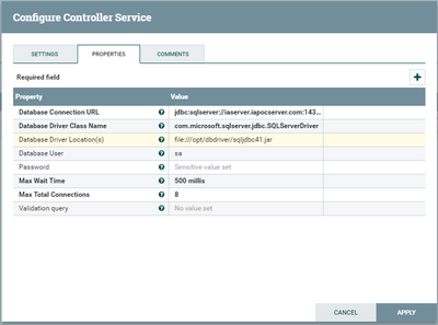

Hi @Matt Burgess,
I am facing the same problem and the solution you suggested is not working for me. Can u provide with some alternative solution. Configuration and error is given below. Nor the solution by Matt Clarke is working for us.

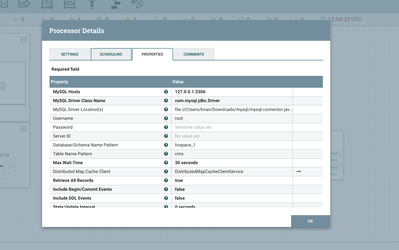

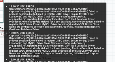

Hello @Matt Burgess .
I am using the CaptureChangesMysql processor to read the events data from mysql but it it failing with the connection error as "org.apache.nifi.reporting.initializationexception can't load database driver"
screenshots are attached for the reference .
Mysql Driver path: file:////Users/kiran/Downloads/mysql/mysql-connector-java-8.0.17.jar
