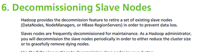

I thought the proper way to do the maintenance on the data node is to decommission it, so it can do the following tasks:
In a urgent situation, I could agree on your suggestion.
However, please advise me the right approach in a scenario where you have luxury to choose the maintenance window.
