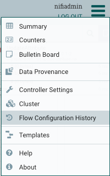

- The nifi-flow-audit.h2.db is used by NiFi to keep track of all configuration changes made within the NiFi UI. The information contained in this DB is viewable via the "Flow Configuration History" embedded UI found under the Upper right corner hamburger menu in NiFi's UI:
You can use NiFi's rest API to query the Flow Configuration History.
