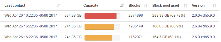

The number of blocks on each node is too high and my threshold is 500,000. Do you think adding some disk in the server and then changing the threshold would help?

It seems in your case, you have to
1. add additional disk/node
2. try rebalance after that
3. changing the threshold to a reasonable value. Because this threshold will help you to fix the issue before it breaks

@ShilpaSinha what is the total size of your cluster and the total blocks.
Seems you are writing too much small files.
1- Adding more nodes or disk to handle number of blocks isn't the ideal solution.
2- If you have an enough memory in the namenode, and the storage is fine in the cluster, just add more memory for the namenode service.
3- If you have a scheduled jobs try to figure which job is writing too many files and reduce it's frequency.
4- The best solution to handle this issue is to use a compaction process as part of the job or a separated one.

@ShilpaSinha I am also kind of agree with @Fawze because there will be multiple options for the same issue
I've suggested to add addition node in my 2nd update as the total capacity of your cluster is very less (not even 1 TB). So if it is affordable for you better add additional node, also consider the suggestion from @Fawze to compress the files
As mentioned already you don't need to follow "either this or other option", you can try all the possible options to keep your environment better
