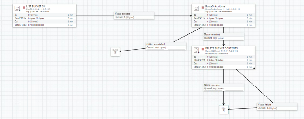

If I connect ListS3 process --> FetchS3Object-->RouteonAttribute (to obtain the file name and discard the path that came as file name too using matched and not matched) -->DeleteS3Object to do the delete action. All the process work well and I don't have error but the files is not delete.

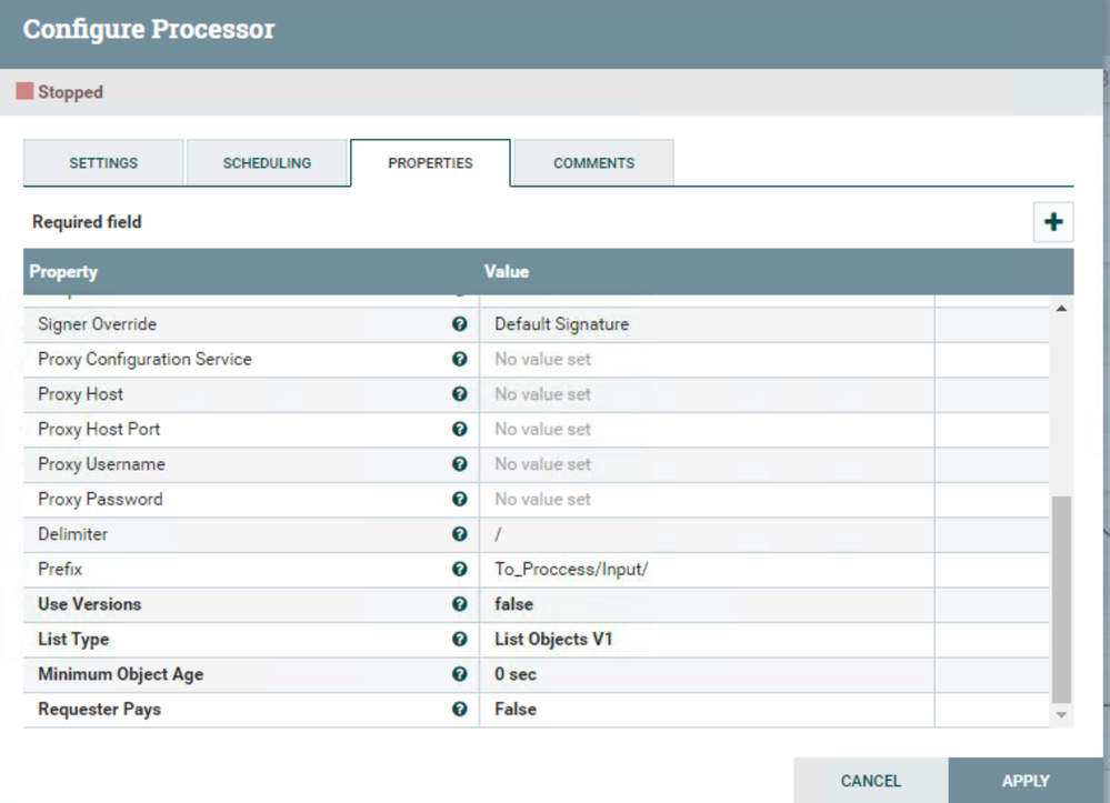

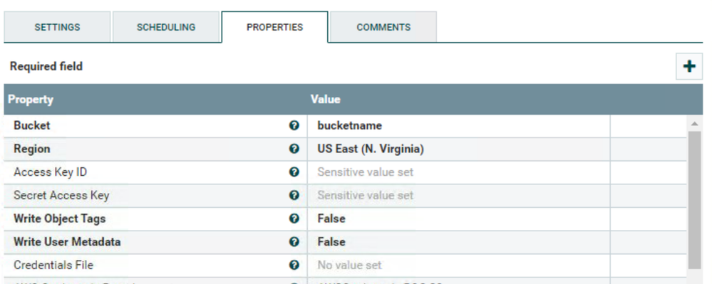

I had to set the bucket name, delimiter and prefix as shown in the second and third images.Delete S3 2.PNGDelete S3 3.PNG
The prefix is used to filter the files from the path.
(In this case
Buketname/To_Proccess/Input/

The delimeter is '/'

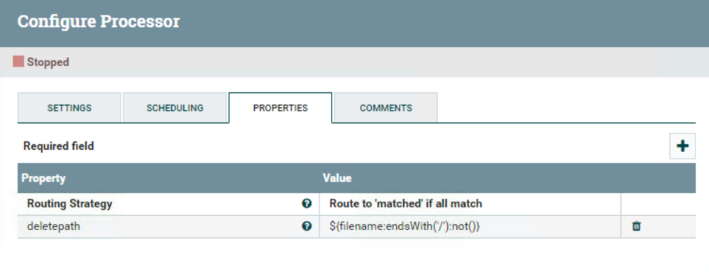

After that I use RouteOnAttribute and set it to filter the '/' as is showed in the picture:Delete S3 4.PNG

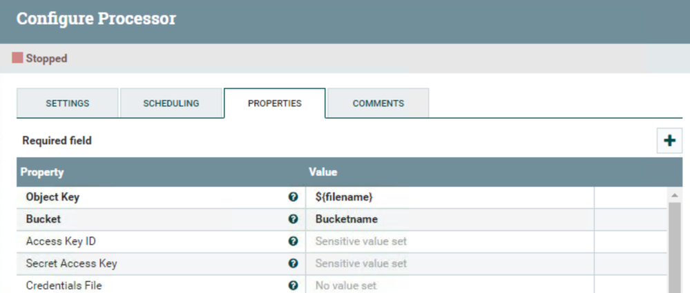

And the last step is configure DeleteS3Object process where only have to set the name of the bucket. In my case 'Bucketname'.

All these proccess delete File1.txt, File2.txt, File3.txt but not delete the path '/To_Proccess/Input/' inside the bucket.
(In this case
