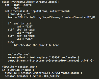

Hi Team,
I want to either delete or stop the flow files which didn't satisfy the condition in execute script.
I'm getting lot of flow files into my execute script processor out of which didn't satisfy the condition needs to be stopped/deleted at the execute script processor it self and whichever the flow files satisfy the condition needs to move to the next step. Can we stop/delete the flow files in execute script processor.
Below is the logic inside the execute script.

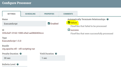

As you are not transferring any of the flowfiles to REL_FAILURE, Transfer the else flowfiles to failure relation and auto terminate the failure relation,
else: session.transfer(flowFile, REL_FAILURE)
Auto terminate failure relation
(or)
You can use session.remove to remove the flowfile
else:
session.remove(flowFile)
by using any of the above ways you can achieve same result as you are expecting.
