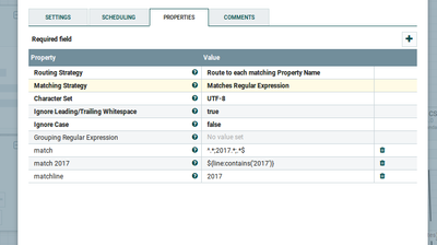

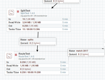

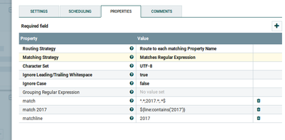

I got a problem with extracting/deleting these lines:
It looks like this: 42586-bildschirmfoto-vom-2017-11-14-141356.png
with following properties in RouteText (testing it out with different options)
42587-bildschirmfoto-vom-2017-11-14-142103.pngIt is still sending all lines to the next processor. (or none)
Do you have an idea of an solution?

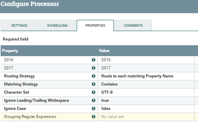

if you want to filter out 2016 and 2017 records then in route on content processor change the below properties
Routeoncontent with Contains as Matching Strategy:-
Keep Matching Strategy as Contains
Route Strategy as Route to each matching Property Name
add new properties
1.2016 as 2016 //check for content if it contains 2016 then route to this relation
2.2017 as 2017 //check for content if it contains 2017 then route to this relation

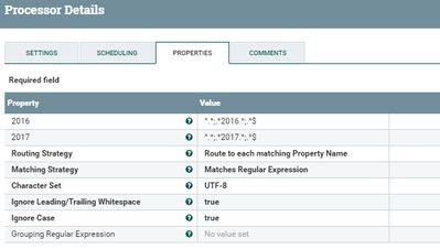

Routeoncontent configs:-
(or)
Routeoncontent with RegularExpression as Matching Strategy:-
If you want to check the contents of flow file with regular expressions then
Keep Matching Strategy as Matches Regular Expression
add new properties
1.2016 as ^.*;.*2016.*;.*$  //check for content if it contains 2016 then route to this relation
2. 2017 as ^.*;.*2017.*;.*$ //check for content if it contains 2017 then route to this relation
Routeoncontent with RegularExpression Config:-
add new properties
(or)
add new properties
Flow:-
ListFile --> FetchFile --> SplitText //split into 1 line --> RouteonContent //you can use either Contains (or) matches regular expression As Matching Strategies --> .... -->PutCassandraQL
