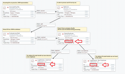

Looking at the above Json list we expect that every item will be a non duplicate item in Distributed Map Cache Server. But it is not what is happening.

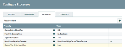

Here is the Detect Duplicate Propertie configuration:
When I start the process flow look what happens:
Only the first ID is detected as a non duplicate as you can see in the LogAttribute - Non Duplicate data provenance:

Hi @Gabriel Queiroz,
If you'd like to use ID FlowFile attribute from DetectDuplicate processor's 'Cache Entry Identifier', you need to use NiFi Attribute Expression Language syntax. Currently you have configured it as '$ID', but you need it as '${ID}' (wrap it with a curly bracket).
4 REPLIES 4
