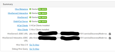

I'm facing difficulties in connecting to Hiveserver2 JDBC and Hiveserver2 interactive JDBC URLs on my HDP 2.6.5 cluster.
Using DBeaver, I'm able to connect directly to port 10000 of Hive server. Connecting to the URLs shown in Hive summary page (port 2181) in Ambari throws several the following exception:
Could not open client transport with JDBC Uri: jdbc:hive2://nn1.int.net:2181: null
