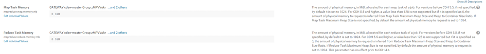

Hi @Jerry, thank you for the reply.
If I understand correctly you are saying that if not explicitly specified values for mapreduce.map.memory.mb and mapreduce.reduce.memory.mb YARN will assign to the job the minimum container memory value yarn.scheduler.minimum-allocation-mb, (1 GB in this case) ?
Because from what I can read in the description fields on the Cloudera Manager, I though that if the values for mapreduce.map.memory.mb and mapreduce.reduce.memory.mb are left to zero, the memory assigned to a job should be inferred by the map maximum heap and heap to container ratio:
Could you explain please how this work?
