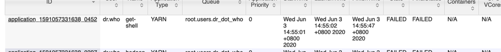

Dr.who is running on my CDH 6.3, I've seen its crontab also using YARN user:
I've already remove the files of this and I want to implement some restrictions using firewalld,
how can I block this virus on running on my YARN 8088? do I need to block the 8088 port in all nodes? and what IP addresses do I need to insert for whitelisting? below is my current rules in firewalld:

thank you for sharing with us your concerns. I believe you were referring to the thread under [1].
dr.who is a username used for all unauthenticated users who submit job to YARN. You can be subject to malware attacks when your cluster is not secured and connected to the Internet. Please see [2] on this topic and how to remedy.
Please always secure your cluster [3]. Make sure you enable authentication for web consoles [4] (securing your UIs). Once enabled, secured web UI will require SPNEGO to be configured on the browser you are accessing it e.g. the YARN Web UI.

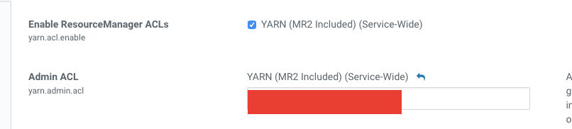

You should set yarn acls to restrict user access on YARN.
Please check if dr.who is part of yarn admin acl configurations in YARN. Remove the user in this case and set dedicated user and groups for yarn access

Hi @paras do you think this is now somehow sufficient? only the know users are indicated on the Admin ACL, can dr.who no longer ran a job in my yarn? :

You would still need to secure your cluster since any user can be impersonated in a non kerberised cluster.
Refer https://blog.cloudera.com/how-to-secure-internet-exposed-apache-hadoop/
for more details on securing your cluster.
