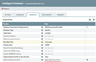

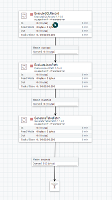

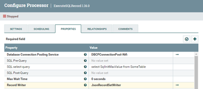

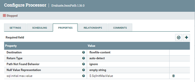

I noticed that the added dynamic property initial.maxvalue.<max_column_name> accept expression language (EL) so since the GenerateTableFetch can take incoming relationship maybe you can use ExecuteSQLRecord to fetch the initial max value from sql into json format then store it in a flow file attribute using EvaluateJsonPath processor which you can reference to set the initial.maxvalue.<max_column_name> property value as follows:
ExecuteSQLRecord Config:
EvaluateJsonPath Config:

Hi @SAMSAL, I haven't tried it yet but your proposal makes sense, but the execute sql record will run constantly and required manual intervention to stop it so to produce only one flow file. However this is another case

How often are you looking to run the GenerateFetchTable ? If its going to be a batch process then you can set up the a schedule on the top processor using processor config -> Scheduling tab and setting the Run Schedule value. By default this value is set to 0 secs which means its continuously running.
