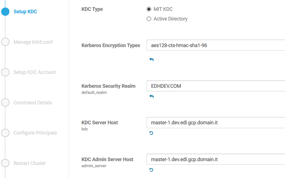

I run the wizard in CM to enable Kerberos on my cluster.
I set KDC host and Encryption type according to previous output

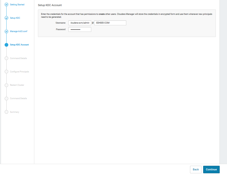

Here I configure the principal but nothing happens when I click on Continue:

Continue button is enabled but pressing it does nothing and procedure remains on the same page.
Nothing is written in krb5 or cloudera manager log files.
I've raised cloudera manager's log4j level to DEBUG but still nothing is traced when I press Continue button
