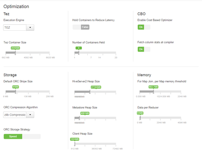

The Hive config in Ambari is as follows(Tez is the execution engine) :

I have several questions pertaining only to the usage of Tez :
  1. Can I safely assume that Tez is the execution engine right now ? Does Tez maintain its logs where the Hive query execution is logged ?
  2. I read in the Hortonworks doc. about enabling Tez, it is necessary even when Ambari is used ?
  3. Can the change in the Hive config via Ambari seamlessly switch between Tez and MapReduce ?
  4. I checked the Apache Tez doc. but I am unclear about the utility of the Tez UI ?

1) yes you can see the "Tez session was closed ...
2) In anything after HDP2 tez is enabled by default. MapReduce might be going away as an option anyway
3) You can still use set execution engine in queries set hive.execution.engine=mr or tez
4) Not sure what you mean with utiliy. The Tez view in ambari would provide the functionality I am not completely sure about the out of the box integration with resource manager
https://www.youtube.com/watch?v=xyqct59LxLY
