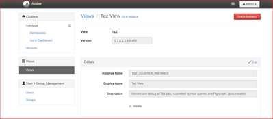

Contributor
@Jay SenSharma
Yes i am using a default Tez view.This is the screenshot.
But from your above reply i got a temporary solution. I created a new Instance of TEZ-View and its working. But the all my last query DAG are not imported in this new view.
Any suggestions???
