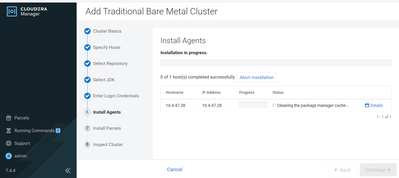

I am getting the below error while installing the agent. I am working on Ubuntu 20.04. It's a single machine cluster I want to make. Can anyone help me out with this?
Cleaning the package manager cache... View Failed to acquire installation lock. View

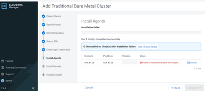

But, after fixing this, I am getting this error "Monitor-HostMonitor throttling_logger ERROR Failed to collect NTP metrics". I have not installed NTP on my server. Do I need to ?? Do you have a any Idea??
Check this screenshot.

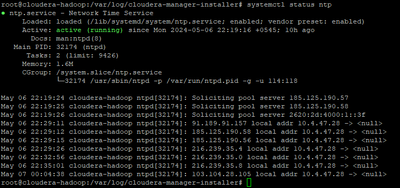

Hello @Scharan , I installed the NTP, but still the same error.

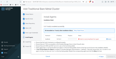

avi_fcb_0-1715051475234.pngavi_fcb_0-1715051475234.pngavi_fcb_1-1715051499739.pngavi_fcb_1-1715051499739.png
Any suggestions on what went wrong?
