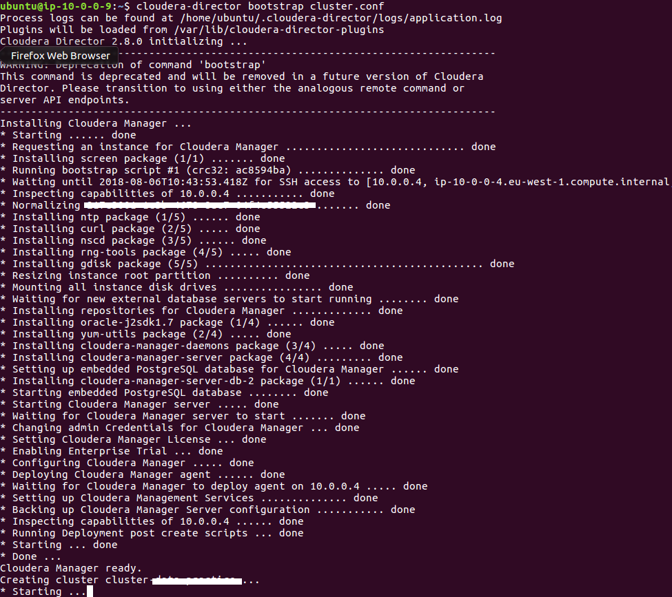

In both situations Cloudera Director gets stucked at:
(Web)
Fails with red error screen
(Client)
Installing Cloudera Manager ...
* Starting ...
and if I see the log, in both cases appear:

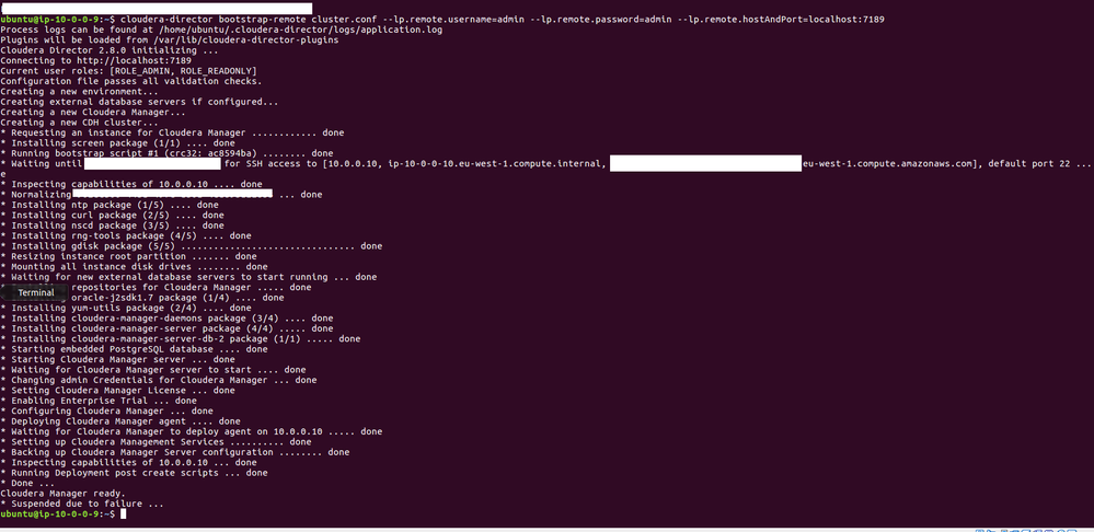

1. Tried
worked at the beginning, but stopped suddenly with an error, and if I look at the director logs there was no error:

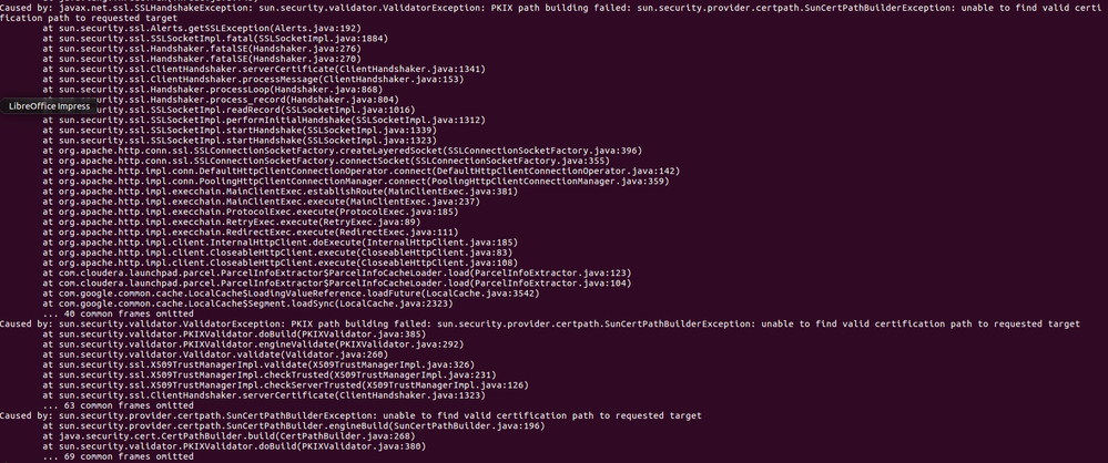

2. Tried
worked at the beginning but also failed at the end. This time there was registry at the director logs:
seems to be another bug this time with the Java installation at the Cloudera script, don't you think so?

For case #1, when using bootstrap-remote, most of the work is done on the associated Director server, so check the logs there for problems. It could be the same problem that surfaced in #2.
In #2, the error is occurring when Director is failing to access the CDH parcel repository over https. Are you hosting your own repository, or have you customized the Director truststore to no longer include common trusted certificates?
