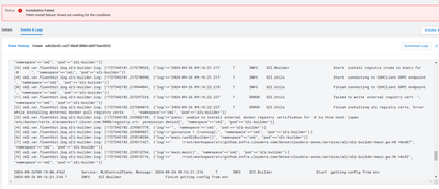

Embedded Container Service 1.5.1, CML installation keeps getting stuck and eventually fails with a timeoutsteinsgate_0-1727343789368.png

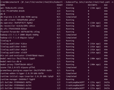

check the CML pod:
/var/lib/rancher/rke2/bin/kubectl --kubeconfig /etc/rancher/rke2/rke2.yaml -n cml get po
We found that the status of the s2i-builder pod is CrashLoopBackOff.

After a while, connect to GRPC.
[0] cml.var.fluentbit.log.s2i-builder.log: [1727342182.219944841, {"log"=>"2024-09-26 09:16:22.218	7	INFO   	S2I.Utils                     	Finish connecting to CDHClient GRPC endpoint	", "namespace"=>"cml", "pod"=>"s2i-builder"}]
Then there is this error:
[1] cml.var.fluentbit.log.s2i-builder.log: [1727342182.227297224, {"log"=>"2024-09-26 09:16:22.227	7	ERROR  	S2I.Utils                     	failed to write external registry cert	", "namespace"=>"cml", "pod"=>"s2i-builder"}]
[2] cml.var.fluentbit.log.s2i-builder.log: [1727342182.227304019, {"log"=>"2024-09-26 09:16:22.227	7	ERROR  	S2I.Utils                     	Finish installing s2i registry certs, Error while installing external docker pull registry certs 	", "namespace"=>"cml", "pod"=>"s2i-builder"}]
[3] cml.var.fluentbit.log.s2i-builder.log: [1727342182.229502149, {"log"=>"panic: unable to install internal docker registry certificates for :0 to this host: [open /etc/docker/certs.d/ecsworker1.clover.com:5000/registry.crt: permission denied]", "namespace"=>"cml", "pod"=>"s2i-builder"}]
[4] cml.var.fluentbit.log.s2i-builder.log: [1727342182.229507778, {"log"=>"", "namespace"=>"cml", "pod"=>"s2i-builder"}]
[5] cml.var.fluentbit.log.s2i-builder.log: [1727342182.229509027, {"log"=>"goroutine 1 [running]:", "namespace"=>"cml", "pod"=>"s2i-builder"}]
[6] cml.var.fluentbit.log.s2i-builder.log: [1727342182.229510284, {"log"=>"main.runS2iBuilder()", "namespace"=>"cml", "pod"=>"s2i-builder"}]
[7] cml.var.fluentbit.log.s2i-builder.log: [1727342182.229511427, {"log"=>"	/root/workspace/src/github.infra.cloudera.com/Sense/cloudera-sense/services/s2i/s2i-builder/main.go:68 +0xd67", "namespace"=>"cml", "pod"=>"s2i-builder"}]
[8] cml.var.fluentbit.log.s2i-builder.log: [1727342182.229512764, {"log"=>"main.main()", "namespace"=>"cml", "pod"=>"s2i-builder"}]
[9] cml.var.fluentbit.log.s2i-builder.log: [1727342182.229513716, {"log"=>"	/root/workspace/src/github.infra.cloudera.com/Sense/cloudera-sense/services/s2i/s2i-builder/main.go:36 +0x32", "namespace"=>"cml", "pod"=>"s2i-builder"}]

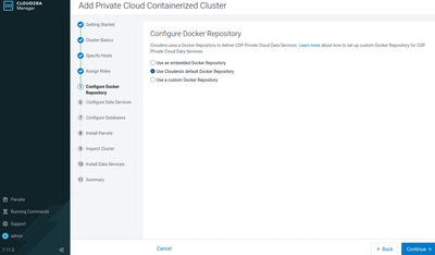

We use Cloudera Default Docker Repository to install:
