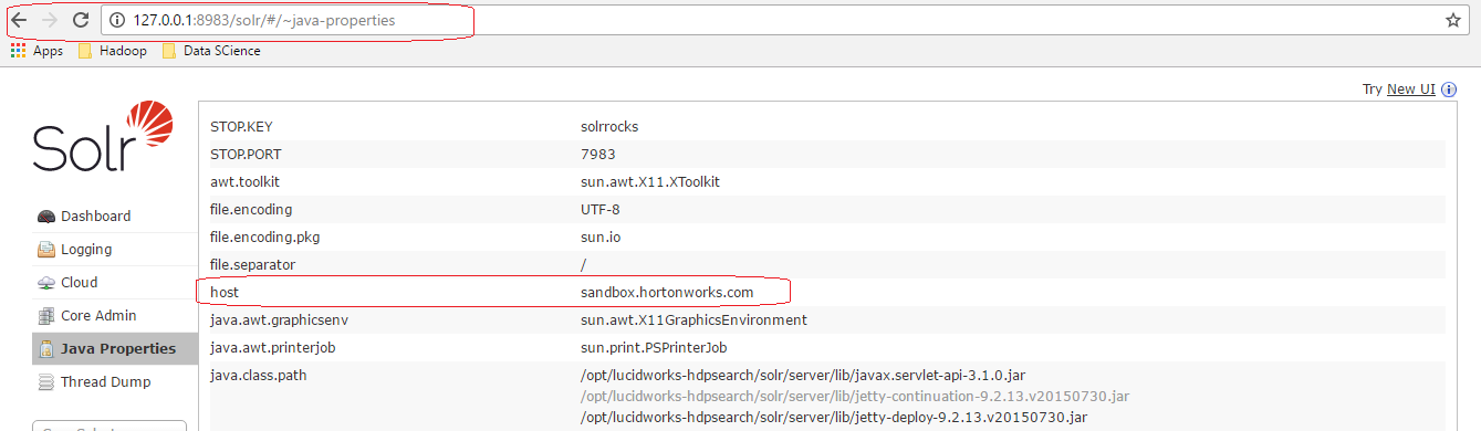

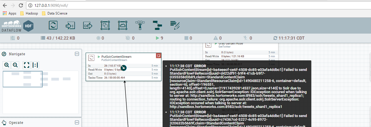

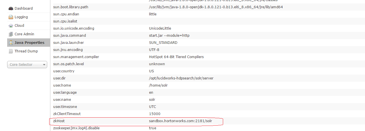

I have spinned up solr through Ambari and Nifi is installed on hortonworks sandbox. When I added processor "putsolrcontentstream" it gave me an error "IOException occured when talking to server at: http://sandbox.hortonworks.com:8983/solr/tweets_shard1_replica1". My guess is that Nifi is trying to connect to http://sandbox.hortonworks.com:8983/solr/tweets_shard1_replica1 whereas tweets_shard1_replical is in below address and i can see it in my browser http://127.0.0.1:8983/solr/tweets_shard1_replica1 I checked on solr UI --> Java properties that HOST is given as sandbox.hortonworks.com and ZKHOST is given as sandbox.hortonworks.com:2181/solr QUESTION: How to replace and where to replace sandbox.hortonworks.com with 127.0.0.1 so that I no longer get error on putsolrcontentstream processor on nifi. Attached are relevant screenshots for reference purpose. Please help.

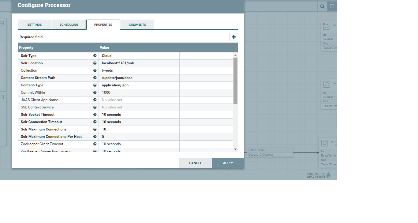

In the PutSolrContentStream processor, did include the Collection name in the properties? What are the other properties that you have set in processor.
Please find attached then screenshot of PutSolrContentStream properties. Please let me know if I'm missing anything.
when you started solr, did you specify localhost:2181/solr as the zk location? i.e. /solr.sh start -c -z localhost:2181/solr. If not, make sure the zk location you started in the solr setup is the same in the PutSolr properties. I've also had times where I had to recreate the index to get this error message to go away.
