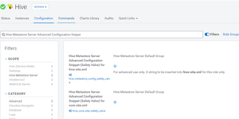

Contributor
Hi
We are also getting same issue .
what property should be changed here?
this is from my env.
Please let me know.
Thanks in advance..
Srini Podili

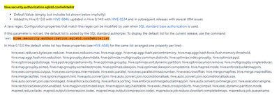

Contributor
Hi Asish.
I saw this info from Apache documentation.
https://cwiki.apache.org/confluence/display/Hive/Configuration+Properties#ConfigurationProperties-Hi...
Thanks,
Srinivas
