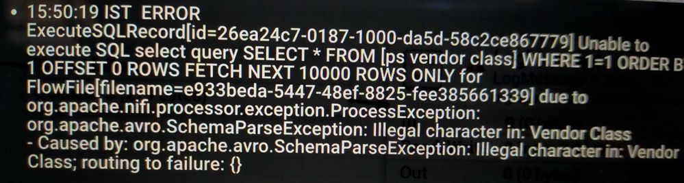

Hi ,
Am using MSSQL version 12+ , I have connected to DB successfully . I could able to fetch the data eg : Select * from dbname.sys.tables

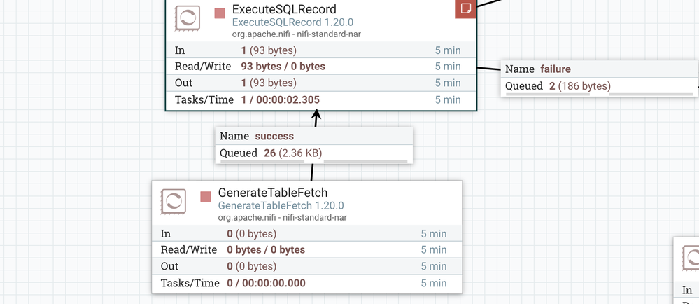

But If i try to query fetch the table records using below processor
Getting below error  :
1 ACCEPTED SOLUTION
Master Collaborator
This error has to do with the schema used in Record Writer controllers used by ExecuteSQLRecord.
I would validate the provided schema and check if it is in the correct Avro format as it Avro schema parser is complaining about an illegal character in the provided schema.
