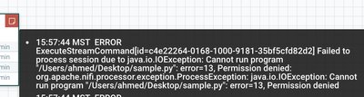

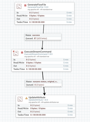

I want to create a simple flow that executes a Python script stored in a local directory. The flow will process data fetched from a source directory, then pass it to to a Python script, and generate an output file which will be stored in a target directory.

However, the ExecuteStreamCommand keeps returning an error "Permission denied". I tried running NiFi : sudo ./nifi start, but the problem persisted. (https://community.hortonworks.com/questions/35453/how-to-run-one-nifi-processor-as-super-user.html)

I started NiFi 1.8.0 again after the videos, and now I had the policy icons in my UI. Also, in the workflow.png, you can see on the top right of the UI 'CN=sys_admin', which I believe it means that I opened NiFi as the sys_admin user that I've created. I created the same flow as before, and this time, I changed the policies for the admin, and included the admin under 'access restricted components' & 'regardless of restrictions'. Just in case, I added the admin under each sub policy under 'access restricted components'. The problem still persists.
Whats the cause behind the error? And how can I resolve this issue? Any help and suggestions are appreciated.

I was able to solve the issue by running the command 'chmod +x sample.py'. NiFi was able to run the external Python script afterwards.

@Saisreenath According to this article: you should be in the folder containing the script you want to execute to set the execution permissions.
Nifi needs permissions to access the script.  It also needs permission to be able to execute the command you gave it.  In your error it is saying it cannot run the python command.  You may need to adjust that command path.   In summary make sure you give correct permissions to everything you put in Properties tab of the NiFi Processor, and use the correct paths for python.
