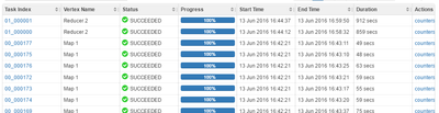

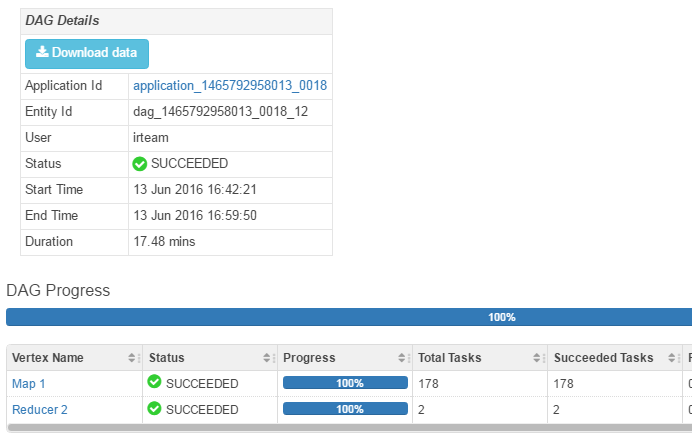

And It took 17 minutes in total which several times longer than I expected.
This is the result of TEZ DAG. Most of the time spent on Reduce job(15 minutes) .

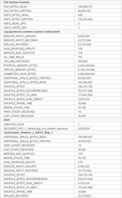

And this is the task counter of one of the reducer task.
With this data could you please point out the time consuming factor of the reduce task?

Not sure what you mean with consuming factor. You can see that the reducer took 15 min and had 23m records as input. You can also see that the shuffle had 500MB. Which should not take 15 minutes in the reducer to count by group. So I am wondering if you by any chance do not have enough memory for the reducers and they cannot keep the groups ( 8m ) in memory or something.
You should definitely increase the number of reducers. Since you have 8m groups and both tasks took a long time ( so most likely not a single huge group ) you can essentially create as many as you have task slots in the cluster. But I would also look at my hive memory configuration to see if I would increase the task memory and have a look at what happens on the machines running a reducer since aggregating 23m rows should not take 15 minutes.

It turned out to be log level problem.(It had set to debug).
And I will also try to increase mapper count. ( each container's heap size set to high enough)
