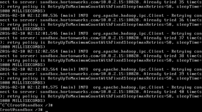

I seem to be stuck once again as I work my way through the Hortonworks Tutorials. I am currently working "Exploring Data with Apache Pig from the Grunt shell" and stuck on the step "DUMP Movies;"
I seem to me stuck in a loop that is waiting on "sandbox.hortonworks.com/10.0.2.15/:10020. Already tried 38 times ............"
I have attached a screen for clarification.

@Mike Vogt How much memory have you allocated to Sandbox? Make sure that you shutdown hbase and any other component that you don't need.
Can you share screenshot of ambari?

@Mike Vogt Make sure HDFS, Mapreduce and yarn is running
port 10020 belongs job history server.

Hi Artem -
I appreciate you looking into this. I checked the directories and permissions and they were all in order.
The issue turned out to be yarn and mapreduce needing restarts. So I restarted, and got through the immediate crisis.
But I do appreciate you taking a look nonetheless.

New Member
Aha! I checked Mapreduce and yarn, and they both were requiring restarts. Completed the task, and back on track.
