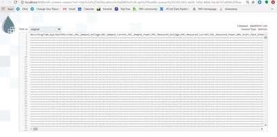

I have a CSV file from which i need to extract two values like 'UutId & Test' and place it in the last column (filename) i generated by using 'CSVSetWritter' in UpdateRecord. How can i pull/extract values from same CSV file and place it in the last column of the same CSV file called 'filename' which is blank(without any values right now). If possible please tell what processor and configs to use?TIA
For reference i am attaching CSV file snapshot of value i want to add in the last column called 'filename' repeated in the whole CSV records.

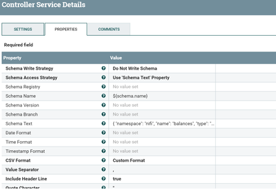

in CSVRecordSetWriter controller service add filename column with string type as last field in the avro schema.

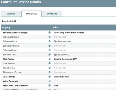

CsvReaderConfigs:
CsvRecordSetWriter avro schema:
"namespace": "nifi",
"name": "balances",
"type": "record",
"fields": [
{"name": "UutId", "type": ["null", "string"]},
{"name": "Test", "type": ["null", "string"]},
{"name": "filename", "type": ["null", "string"]}
Configs:
Ouput:
UutId,Test,filename
1,2,12

@Shu Please find attached the list queue after GetFile.
As soon as i start my UpdateRecord the List queue become blank. attaching the listqueue after UpdateRecord processor
Expected output is to concatenate the row 9th value (FEBetaPack01) and 23rd row value (FE_ChargerSim_CurrentRipple)under column 'filename ' as (FEBetaPack01-FE_ChargerSim_CurrentRipple).
