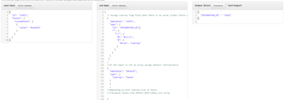

Expert Contributor
Hi @SAMSAL ,
Am I missing something on the JOLT?
Not getting output as expected. (DEFECT_ROOT_CUASE) columns is missing from output.
--Input
  "id": "33414",
  "fields": {
    "customfield_10161": [
        "value": "Backend"
        "value": "Frontend"
--JOLT Spec
  // Entries (where "flat" "data" when there is an array) (now starts at 8)
    "operation": "shift",
    "spec": {
      "id": "INTEGRATION_ID",
        "*_*": {
          "@": "&(1,1)",
          "0": {
            "#true": "isArray"
 //If the input is not an array, assign default isArray=false
    "operation": "default",
    "spec": {
      "isArray": "false"
 //Depending on with isArray true for false
 //Transpose values into DEFECT_ROOT_CAUSE_List_Array
    "spec": {
      "customfield": null,
      "isArray": {
        "true": {
          "@(2,customfield)": {
              "value": {
                "@": "DEFECT_ROOT_CAUSE_LIST[]"
        "false": {
          "@(2,customfield)": "DEFECT_ROOT_CAUSE_LIST[]"
 // Finally, get the last element of the array
    "operation": "modify-overwrite-beta",
    "spec": {
      "DEFECT_ROOT_CAUSE": "=lastElement(@(1,DIRECT_ROOT_CAUSE_LIST))"
--Output
  "INTEGRATION_ID" : "33414",
  "DEFECT_ROOT_CAUSE_LIST" : [ "Backend", "Frontend" ]
Shakib M.
