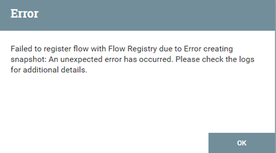

Hi,
My issue related to committing workflow changes onto my Github repository. I have made changes in the providers.xml file and now my Nifi flows are linked to Github flowPersistenceProvider.
However, when I try to commit changes to the same linked repo, it gives me below error:
and in the log files, it says: "Flow version is not added yet, can not be serialized.. Returning Conflict response."

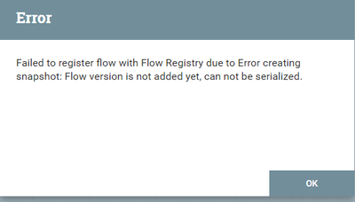

@MattWho thanks for your response.
I followed the documented way to switch between flow persistence providers but still getting an error however, a different now:
I am witnessing that if I commit and push changes to my Git repo using VS Code, the error I mentioned in my last message disappears, however, using UI when I try to commit changes, it is now showing me above error.
In all, I am unable to commit changes to my flows when it is linked with to a Github repo. I am wondering if this functionality that I am trying is even possible?
If it helps, my nifi-registry-app logs are rotating between these two kinds of errors when I make any changes in my workflow:
An unexpected error has occurred: org.apache.nifi.registry.flow.FlowPersistenceException: Git directory <path to git directory on my local machine> is not clean or has uncommitted changes, resolve those changes first to save flow contents.. Returning Internal Server Error response.
I commit and push changes through VS Code (success) since NiFi UI throws error. Then I try to redo "commit local changes" from NiFi UI, it gives below error in my log file.
Looking forward to any guideline.
