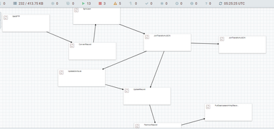

Record reader -JsonTreeReader
record writer - JsonRecordSetWriter this i am using in my update record and for reference this is my flow looks like
