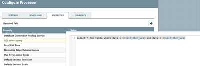

By using ExecuteSql processor you can achieve this use case.
flow:
Update attribute configs:
last_iter_val
${getStateValue("next_iter_val")} //to get the last iteration value
next_iter_val
${getStateValue("next_iter_val"):toDate("yyyy-MM-dd HH:mm:ss"):toNumber() :plus(900000):format("yyyy-MM-dd HH:mm:ss")} //get the last iteration value and add 15 mins to itExecuteSql configs:
By using the attribute values we are going to fetch the records incrementally from the table.
i have attached the xml you can upload that xml and change as per your requirements.
In addition by using same kind of logic you can store your state in DistributeCache/HBase/Hive/HDFS and fetch the state and increment with 15 mins then pull the data from the table.
flow:
last_iter_val
next_iter_val

Hi @Shu, thanks very much the solution is working. But in case of a failure,we are missing the records.
Eg : Run 1:when executing the query between "2018-09-06 12:00:00.00" and "2018-09-06 12:15:00.00" it is processed successfully
Run 2:In next run the query failed for some reason, "2018-09-06 12:15:00.00" and "2018-09-06 12:30:00.00.
run 3:In subsequent run, Db fetch is successful, "2018-09-06 12:30:00.00" and "2018-09-06 12:45:00.00"
In the above case we are missing the records for Run 2 is there a way to maintain transaction of fully commit or rollback, or combine two processor as a single unit of work?
Created 09-08-2018 01:27 PM
For this case please look into this link for storing and fetching the state from distributed cache map.
By using this approach we are updating the state only when the pull has been succeeded, if the pull failed then we are not storing the state.
