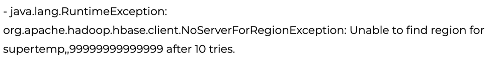

The Job is failing after 10 minutes with an error:

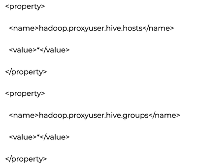

We had a similar issue with beeline not able to run HBASE Commands and the solution was -
I think the issue is that HBase does not allow hive to impersonate users.  So you'll need to setup hive as a proxy user in HBase.  Can you try the following:
- Go to the HDFS service configuration in CM.
- Go to Service-Wide->Advanced and add the following to "Cluster-wide Configuration Safety Valve for core-site.xml":

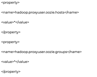

I have added similar entry for OOZIE - HDFS Service-Wide Advanced properties and add the following to Cluster-wide ConfigurationSafety Valve for core-site.xml

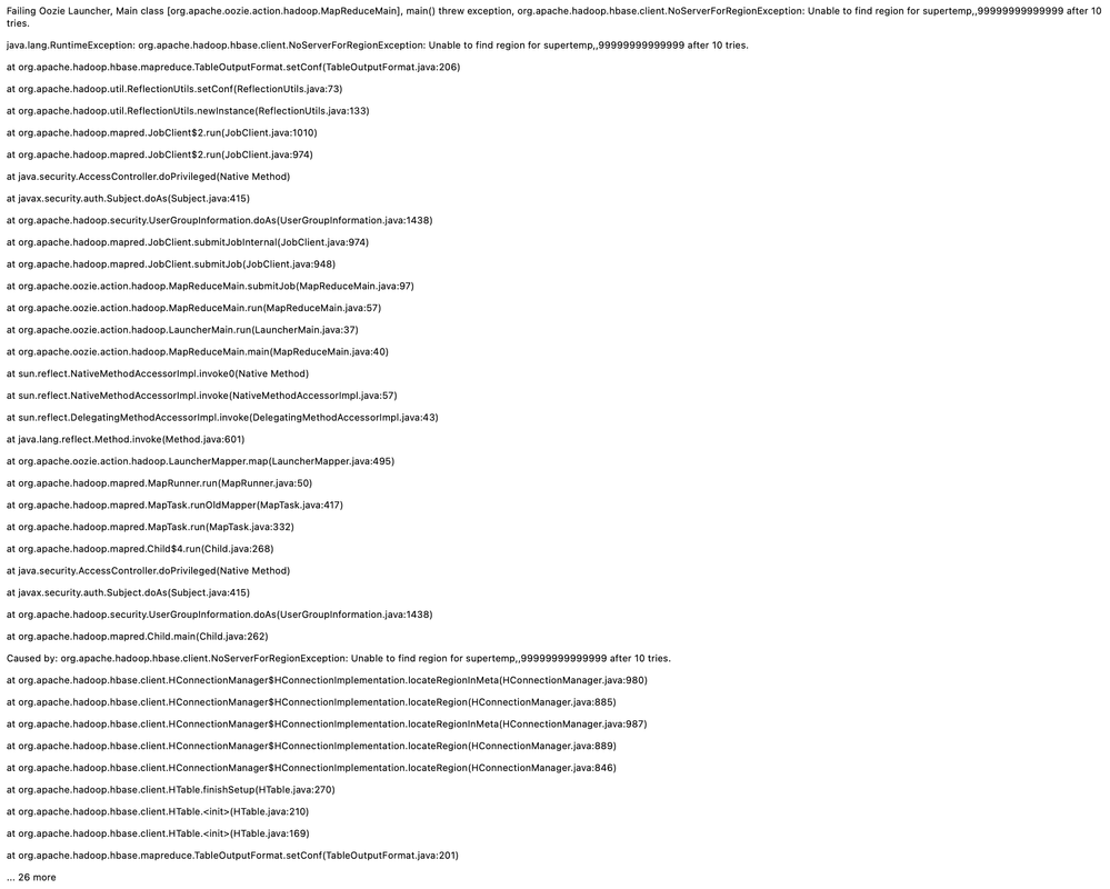

Here is what i have in the logs -
Oozie Launcher failed, finishing Hadoop job gracefully
