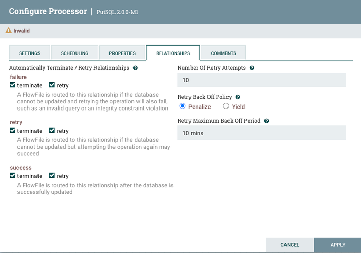

What about the "Relationship" tab?

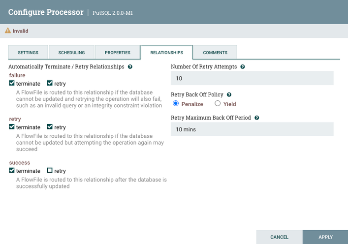

My guess here is that you have checked the "retry" box on the success relationship of the putSQL processor.  If that is the case, unchecking "retry" on the success relationship should resolve your FlowFile penalization issue:
When this processor is running, does it produce any bulletins or exceptions in the log output?  If it is producing bulletins, warn, or error logs, it is likely failing to write to your SQL DB.  The FlowFIle would then be routed to retry or failure relationship depending on exception where "retry" if checked would be applied based on retry property configurations.

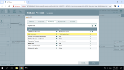

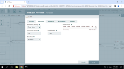

Explorer
Hi this is how i have configured my  PutSQL processor . Let me know if i missed or need to Change any configuration.
@MattWho

@Madhav_VD

Rising Star
In PutSql Processor, there is a property "Support Fragmented Transactions". If set its value to be false, then it is proceeding and not penalising the flow files.
Rising Star
In PutSql Processor, there is a property "Support Fragmented Transactions". If I set its value to be false, then it is proceeding and not penalising the flow files.
