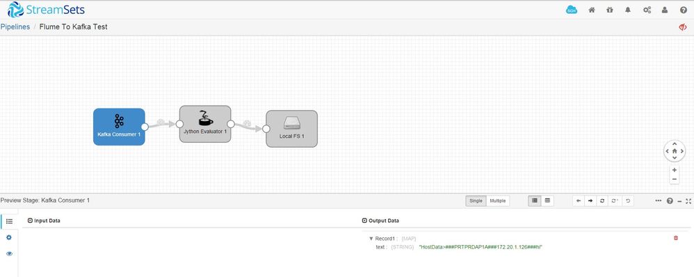

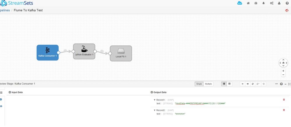

 So I just tested it with Streamsets,
I sent the message 'hmmmm' which Flume separates the interceptor from the message itself and I did receive 2 records:
Then I sent another message 'hi' and receive it as 1 record:
So there is a problem for sure that I didn't figure out yet.
The logs for Flume in both cases are shown below. I don't see anything weird there, what you guys think?

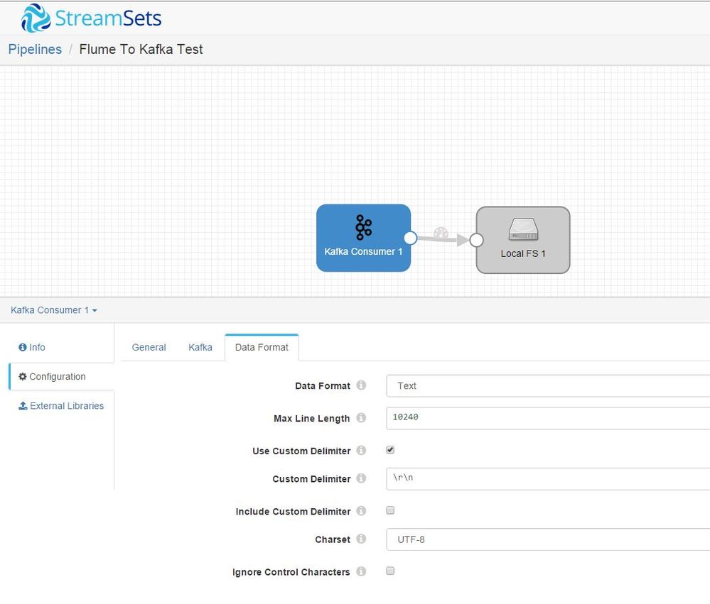

So, I did the following in Kafka Consumer element of Streamsets:
And now it works fine!
I will keep testing it and come back here in a couple of days to mark the post as a solution.
I still notice that the file that I write into has more lines than the number of records that enter it. Even if I marked that Ignore Control Characters in the Kafka element, it still happen.
