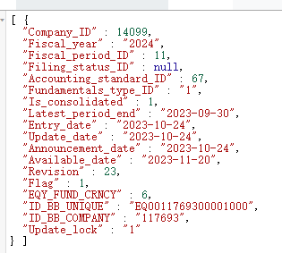

Consider the following example flowfile (representing one record, with many more records in reality):
My goal is to insert this data into 'table1,' which has an auto-incremented ID field (let's assume that after insertion, the ID will be 3001). Could you please guide me on how to retrieve this auto-incremented ID and assign it to a flowfile attribute?

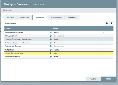

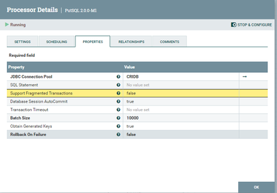

If you use the PutSQL process there is property called "Obtain Generated Keys" which is described as follows:
"If true, any key that is automatically generated by the database will be added to the FlowFile that generated it using the sql.generate.key attribute. This may result in slightly slower performance and is not supported by all databases."
So basically you dont have to do anything extra besides setting this property to true. The new id should be written back as flowfile attribute which will be called "sql.generate.key".

 Here is my setup for Putsql:
Am I done something wrong?

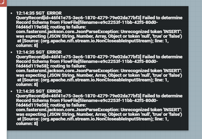

what seems to be the issue? please provide more details . If you are getting any error messages please share
Rising Star
Hi @SAMSAL ,
Please refer to the attachment:
jarviszzzz_2-1705637803853.pngjarviszzzz_3-1705637812280.pngjarviszzzz_4-1705637818114.png

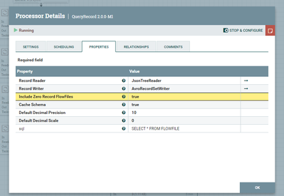

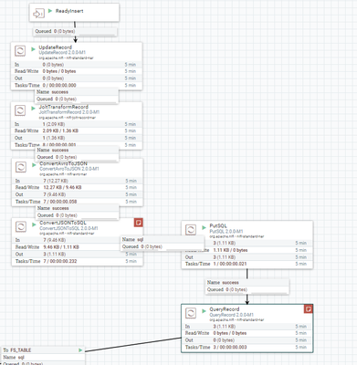

For the "Queryrecord" Processor, I tried to select updated ID from flowfile.
How can I do that to obtain those new ids?
Super Guru

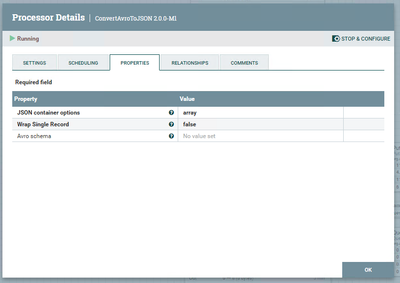

Can you provide screenshot of the ConvertAvroToJson processor? What is the output you are getting out of this processor?
Rising Star

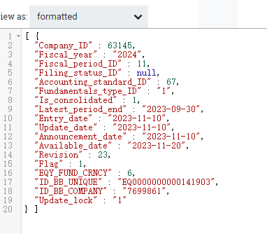

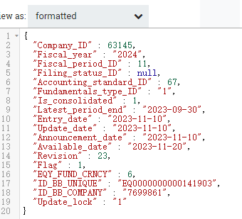

Hi @SAMSAL
Input from data provenance:
Output:

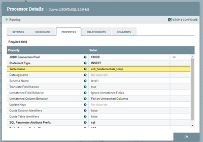

OK, I see what is happening here. The QueryRecord is not needed and its giving you the error because its expecting Json format but its getting an insert sql statement that is created from the ConvertJsonToSQL processor. Does the record get inserted after the PutSQL gets executed on the insert statement? If so then the new id should be written as flowfile attribute "sql.generate.key" and its not going to be part of the flowfile content. The QueryRecord is not needed here and its not used for this purpose. Each flowfile will have a content which is the actual data that it represents and attributes representing the metadata , when you list the flowfile click on the (i) icon in the first column and select the Attributes tab and it should be there with the new ID value. I got confused because the ConvertJsontoSQL is showing an error status in your screenshot
