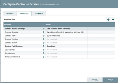

My input flowfile are in json format and I want to convert it into xml. The method I use is using ConvertRecord Processor. In terms of ConvertRecord Processor, I use JsonTreeReader as record reader and XMLRecordSetWriter as record writer. Following picture is the properties of JsonTreeReader I set it up. 

If I have a lot of flowfile that contain this kind of format Json file, what Avro schema should I put inside AvroSchemaRegistry. I try a lot of online converter and it doesn't satisfy AvroSchemaRegistry when I do validation. I need the Avro schema so that the ConvertRecord can read my JSON flowfile.

@FrankHaha
Have you tried using the "Infer Schema" Schema Access Strategy in the JsonTreeReader 1.24.0 controller services instead of fetching schema from AvroSchemaRegistry?
Another option would be to use the ExtractRecordSchema 1.24.0 processor along with JsonTreeReader 1.24.0 controller services configured with "Infer Schema" Schema Access Strategy" to output the schema into a FlowFile Attribute "avro.schema". You can then get the produced schema from that FlowFile Attribute to add to your AvroSchemaRegsitry for future use.
