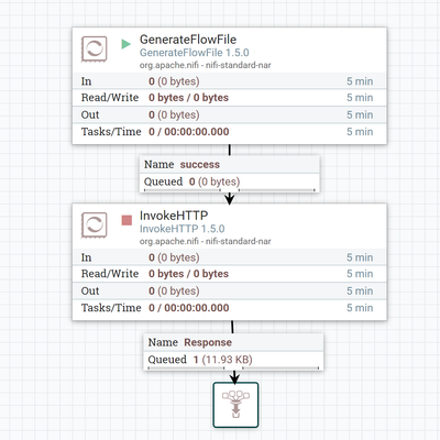

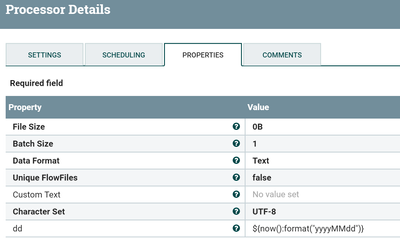

Use GenerateFlowFile processor with Invoke Http processor to get date dynamically.
GenerateflowFile configs:-
in this processor add new property as
dd
${now():format("yyyyMMdd")} //Gives today's date and added as flowfile attribute with dd as name

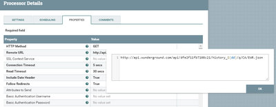

InvokeHttp Processor:-
Change the remote url in Invoke http processor with
http://api.wunderground.com/api/dfe2f11fb7108c21/history_${dd}/q/CA/EWR.json
Use Response relationship from invoke http processor and we are using dd attribute value in the url request, now you don't need to change the url daily.
Schedule the generate flowfile processor to run daily so that invoke http processor will run dynamically.
Flow:-

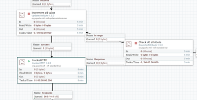

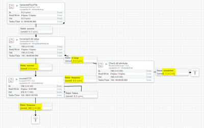

Yes, we can do that for this case we need to fork invokehttp processor response relation to fork 1 response goes for processing, 2 response relation will goes to RouteOnattribute processor to check is the date is in range or not. If in range then we are updating the date and again going to invoke http processor.
Loop:-

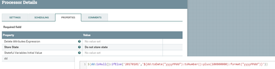

UpdateAttribute processor configs:-
dd
${dd:isNull():ifElse('20170101','${dd:toDate("yyyyMMdd"):toNumber():plus(100800000):format("yyyyMMdd")}')}
Checking dd attribute value if the value is null then 20170101 for the first run we are going to have this value.
if not null i.e from second run we are adding 100800000 milliseconds(i.e 28 hrs because my server configured with est and we need to consider day light saving we need to consider).

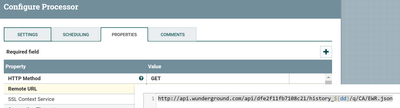

Invoke Http processor configs:-
Remote URL
this won’t change because we are modifying dd attribute value in Update Attribute processor.

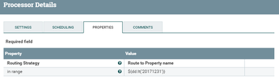

RouteOnAttribute configs:-
In this processor we need to add new property
in range
${dd:lt('20171231')}
Checking dd attribute value less than 20171231 if the value is less than then flowfile will goes to
1.Update Attribute processor and updating the dd value(+1 day)
2.then to invoke http processor fork response
2.1.first-fork goes to Routeonattribute processor
2.2 second-fork goes for processing
i have attached my flow xml, use that for reference and make changes as per your use cases..

Flow:-
Generate flowfile leave as default and schedule by using cron (or) timer driven and running on primary node.
Update Attribute Configs:-
Add new property
dd
Invoke http configs:-
Remote URL
Handle connection timeout issues and another relationships in invoke http processor(no retry..etc)
RouteOnAttribute:-
Add new property as
in range
Connect all the relations as shown in the flow screenshot.
Let us know if you are having issues..!!
