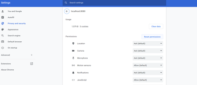

@yvettew
in that pop up window copy the url and paste it in normal chrome browser and then follow the below steps to get rid from 500 error in ambari.
1.1) click on i symbol -> then click on site settings
it will redirect you to that particular tab settings
2)
2.1) click on reset permissions and then click on clear data
Now Go back to that ambari login opening site :
click on reload you will find login page here and error issue will be resolved.
rest permissions and clear data in chrome browser settings
