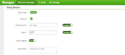

Screenshots of ranger policy:
Master Mentor
@Shilpa Gokul
Is the plugin enabled for kafka?
