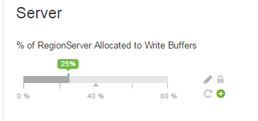

couple of questions. Assuming that load balancer was not enabled before, did you had 6200 regions per region server across the cluster or are there couple of nodes that are offending but rest is okay?
What is the size of your block cache (hfile.block.cache.size)? The sum of block cache and memstore should not be more than 0.8.
0.25 of memstore is actually on the lower end which means you are likely tuning your block cache to a higher value. Otherwise, 0.25 memstore may need to be increased. Your global memstore is 0.25 which means your memstore total should not go beyond (16 GB x 0.25 = 4GB). But with 6200 regions x 128 MB each = 793600 MB = 793.6 GB. this is pretty messed up. You need to bring that region count to a manageable value before you look into anything else. 8 GB for Master is too much but for now, focus on reducing region count.
Re: HBASE Master Heap Size Recommendation
Explorer
Hi ,
Yes,load balancer was not enabled before, i just checked yesterday in HBase Master UI regions are not evenly spread across all region servers,some of the region servers are there with very less number of regions.
The size of hfile.block.cache.size = 0.25(25%).
Yesterday we did some cleanup activity,so HBase average load came-down to 2181.07.
Please suggest what all needs to be done.
Thanks.
Highlighted
Super Guru
Once you have balanced the cluster, and you start seeing your regions moving to other nodes until it's reasonably balanced, then we can decide how to move forward. One of the things is to increase global memstore fraction to 0.4 and block cache to 0.4, but just hold on to it for now until your cluster is balanced. To run balancer from shell, run "balancer" command. to see if balancer is enabled, type "balance_switch". It should give you True. if it's false then run "balancer_switch true". see details on following link under "hbase surgery".
