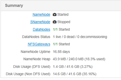

I have a query in relation to Space Allocation within HDFS. I am currently trying to run a large query in Hive (a wordsplit on a large file). However, I am unable to complete this due to running out of disk space.
I have deleted any unnessary files from HDFS and have reduced my starting Disk Usage to 38%.
However, I am wondering what non DFS is as this appears to be taking up the majority of my disk space.
How can I go about reducing the disk space that Non DFS takes up?

You can decrease space for non-HDFS use by setting dfs.datanode.du.reserved to a low value. It's set per disk volume. You can also freed it up by deleting any unwanted files from the datanode machine such as hadoop logs, any non hadoop related files (other information on the disk), etc. It cannot be done by using any hadoop commands.

I believe to delete the logs and other non hdfs data you need to login into machine and execute rm command, but for setting up dfs.datanode.du.reserved property you can login to ambari and search for this property in HDFS > config section(please see attached screenshot). However I think the default value of dfs.datanode.du.reserved is sufficient in most of the cases. Regarding your job whats the data size you are try to process?
