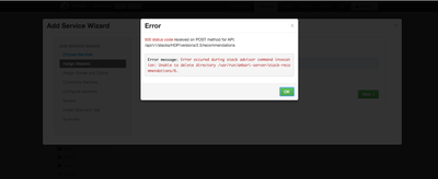

Just downloaded HDP 2.5 Sandbox and tried to install one of existing but not installed services (NiFi) from Ambari UI.
This leads to the following error: 7769-screen-shot-2016-09-19-at-23837-pm.png I've found similar issues mentioned here: https://community.hortonworks.com/questions/50950/ambari-server-wizard-assign-masters-menu-error-occ...
But when I'm trying to change the owner of that directory or even delete and re-create its content (acting as a root) I'm getting the following error:
rm: cannot remove `1': Invalid argument

@Volodymyr Ostapiv , the Sandbox release has been updated, please download it again, you should not face this issue now.

@Volodymyr Ostapiv
Can you please refer below thread
https://community.hortonworks.com/questions/33127/i-cant-add-new-services-into-ambari.html
It looks like permission issue. Can you please try to change owner of /var/run/ambari-server to the user by which ambari-server daemon is running?
Please do let me know if you need any further help.
Highlighted
Re: HDP 2.5 Sandbox can't install a service
@Volodymyr Ostapiv
This is due to an issue in the docker HDP 2.5 Sandbox, which will be addressed with the next Sandbox release.
In the meantime, try the solution in the link below:
https://community.hortonworks.com/questions/62271/unable-to-add-apache-nifi-in-ambari.html

[root@sandbox ~]# ls -lrt /var/run/ambari-server/stack-recommendations/
total 24
drwxrwxrwx 1 root root 4096 Sep 14 06:43 2
drwxrwxrwx 1 root root 4096 Sep 14 06:43 3
drwxrwxrwx 1 root root 4096 Sep 14 06:43 4
drwxrwxrwx 1 root root 4096 Sep 14 06:44 5
drwxrwxrwx 1 root root 4096 Oct 31 09:49 6
drwxrwxrwx 1 root root 4096 Oct 31 09:50 1
Tried to delete:
[root@sandbox ~]# rm -rf /var/run/ambari-server/stack-recommendations/*
rm: cannot remove `/var/run/ambari-server/stack-recommendations/1': Invalid argument
rm: cannot remove `/var/run/ambari-server/stack-recommendations/2': Invalid argument
rm: cannot remove `/var/run/ambari-server/stack-recommendations/3': Invalid argument
rm: cannot remove `/var/run/ambari-server/stack-recommendations/4': Invalid argument
rm: cannot remove `/var/run/ambari-server/stack-recommendations/5': Invalid argument
rm: cannot remove `/var/run/ambari-server/stack-recommendations/6': Invalid argument
Tried change owner:
[root@sandbox ~]# cat /etc/ambari-server/conf/ambari.properties | grep ambari-server.user
ambari-server.user=root
[root@sandbox ~]# chown -R root /var/run/ambari-server/stack-recommendations/
Still no effect. Downloading new sandbox now

Updated sandbox. everything is working now, thanks
