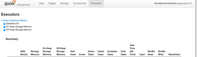

I have created Spark Streaming application which consumes message from Kafka topic. After started the Spark Streaming application in YARN Cluster mode the Spark UI has to show the Streaming Tab to understand the metrics but it is not available.
Is there any configuration available to enable Streaming tab.
